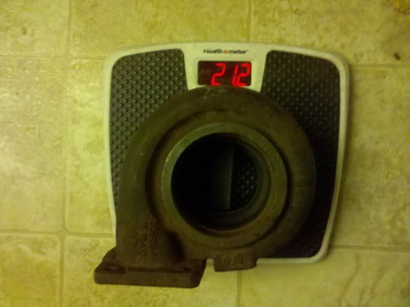

Weights-
Comp. housing: *5.2lbs*
Hotside: *21.2lbs*
CHRA: *12.4lbs*
And if your math is good you will note that together that is:
*38.8lbs* (I'd say its an even 40lbs with the V-Band clams on)

S
Slippi84
I hate to be the bearer of bad news but that is NOT a HX52 pro. The HX52 pro has a bigger wheel than the regular HX52 that also comes with a billet wheel option. Now don't get me wrong I know just as good as any dsm guy how big and badass that thing is in person and for a car looking to still drive on the street and go dumb fast that turbo fits the bill but that is just a regular HX52 with billet wheel. about 85lb/min is doable def with the right supporting mods. Only other thing I would point out is make sure you take out that ring so those antisurge ports can do their job :) good luck with her. I hope you do what I was planning on doing with one.

TSimage
I believe it was Mic'd out previously and the numbers matched. The wheel on this one is bigger than Darren's HX52. The pictures you posted are smaller than the turbo I have so we shall see. I'm excited for the deal either way. Thanks for the heads up, I was going to check to be sure anyways but it was something I couldn't pass up on for the price so its a win-win situation for me.
Its a cool turbo. And if it checks out I'll have no qualms running it. I'm confused by the pictures you posted as they don't reassemble the ones I posted but who knows until I get it all checked out again. They are all dwarfed by the S475 so either way its all about the combo. Hell, the regular HX52s have been putting up 4294 numbers. Those however aren't high enough for what I want so if it doesn't check out as a pro then its back tot he S475.
:rocks:
S
Slippi84
The part number is the giveaway its a regular hx52 and your right it puts up gt4294 numbers just with slightly better spool. I switched because i wanted to utilize a true 5" intake and go with the goal setup but other than that this turbo is pretty much a poor mans gt4294r.
