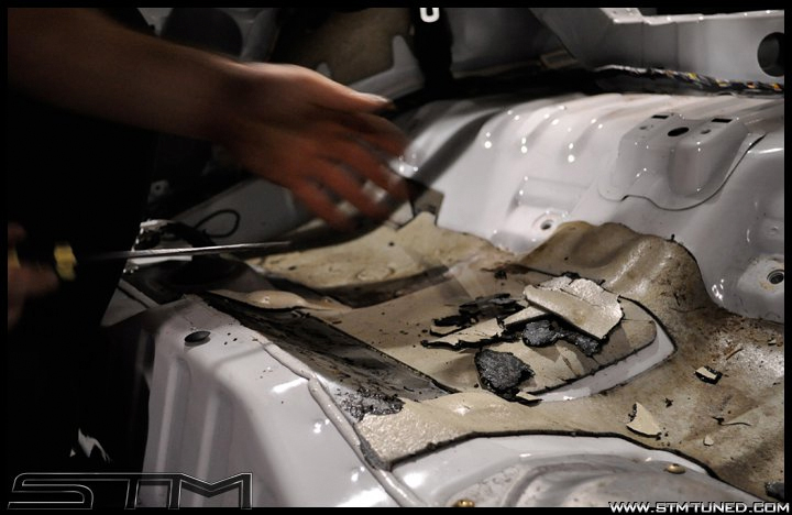

So, the idea here is to get as much out of that 600 whp as possible: Shed the weight.
Here's a picture of when she was all normal and clean:

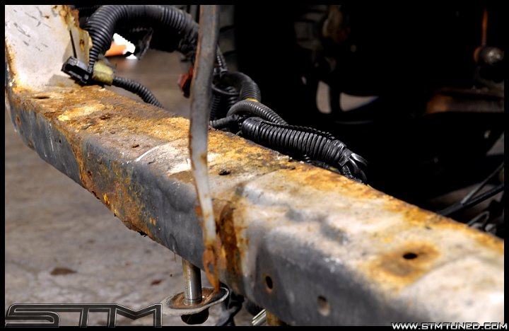

It's a 98 GSX and it's got a bit of the good 'ol NY rust. Best solution: Cut it off!! :hellyeah:

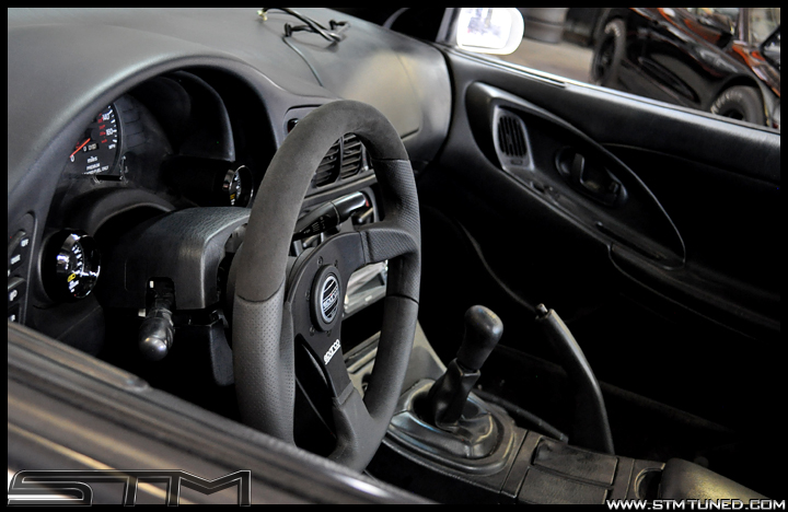

On to the interior. If it doesn't DO anything... it's gotta go! We are still keeping appearances up however, and it will be a fully functional interior. I'm not going to let out all the secrets, but they went to town!

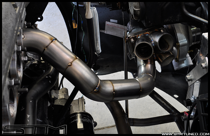

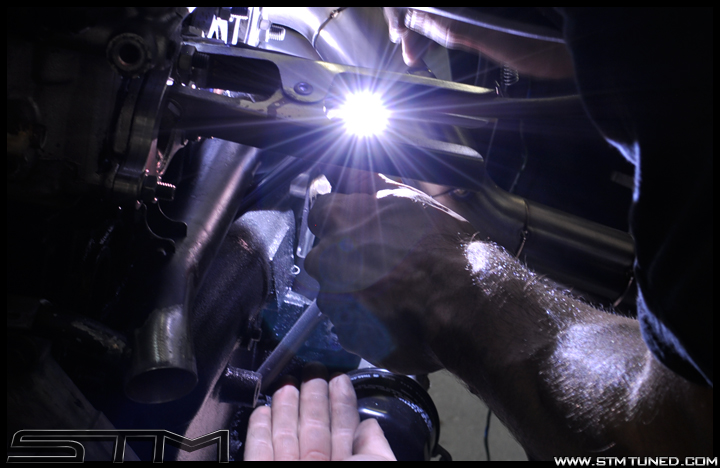

Now for the cool stuff. This GSX will be following with the elite STM crew running a forward-facing turbo set-up, a bit different than our off the shelf manifold, however. We will have pictures of that soon.

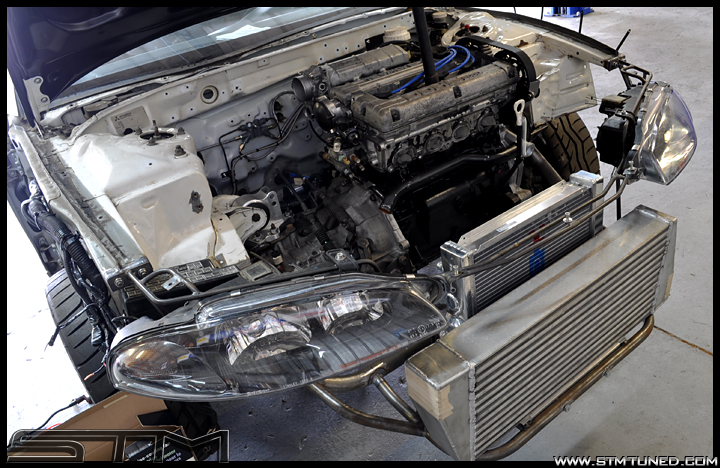

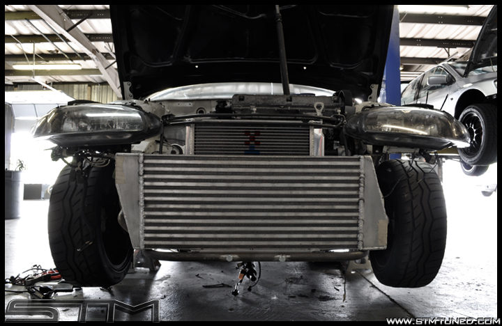

The polished Avid mounts are suspending a Buschur 2.0 built block, and STM Stage 1 head. Up front is an original STM intercooler with a Garrett core and half-sized Koyo radiator.
We've just finished up the custom front end and now starting to piece this puzzle together. Our goal is to have this at the Shootout in a few weeks, so updates will be rolling in quite frequently. We would like to get the car to the paint shop before then, but we will see what time has allotted for us.

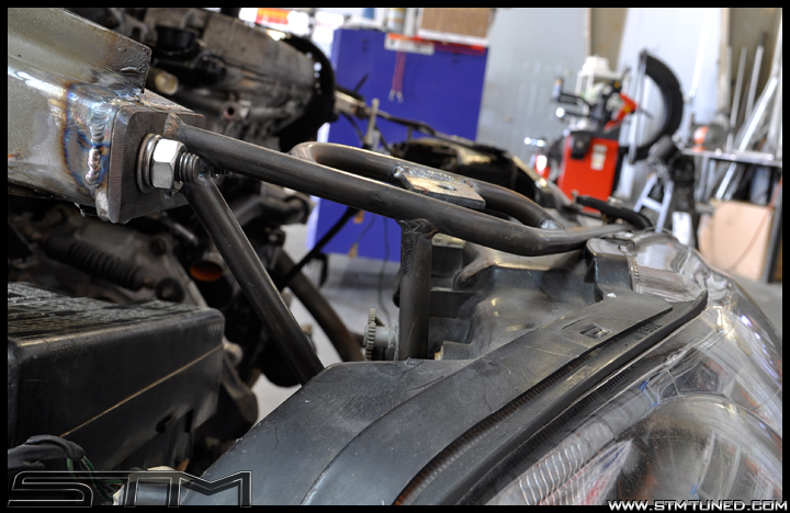

looks awesome!!!! I hope to be at the shootout to see this. I like how you have the half sized radiator laying down long ways as oppose to being offset. I also like like front tube for the torque mount and rad support. I wish someone would make that as a kit for 1g/ 2g owners to shave more weight... HINT HINT!!!. Yes I know there are freelancers on tuners that make tubular front bars to eliminate the north south bars but I like how this actually goes into the frame rails and looks like it shaves off even more weight.

Do yall offer the tubed front in like this 2g has? or is this all a one off build? Im just saying that it would b nie for a vendor to offer something like this for us welderless members lol
4
4G63 girl
This would likely only be something to do in-house at STM. You have to (obviously) cut the frame, and let's just say a customer cuts incorrectly and things don't bolt up right... It would be a disaster waiting to happen. Not worth it from a vendor perspective. But we are more than willing to take in big builds like this and put some more sick DSM's loose on the streets!

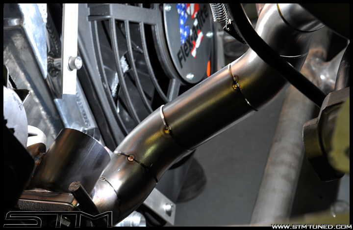

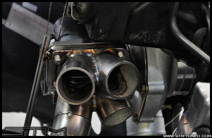

The PTE 6262 is strung up into place and the first manifold runners are started.

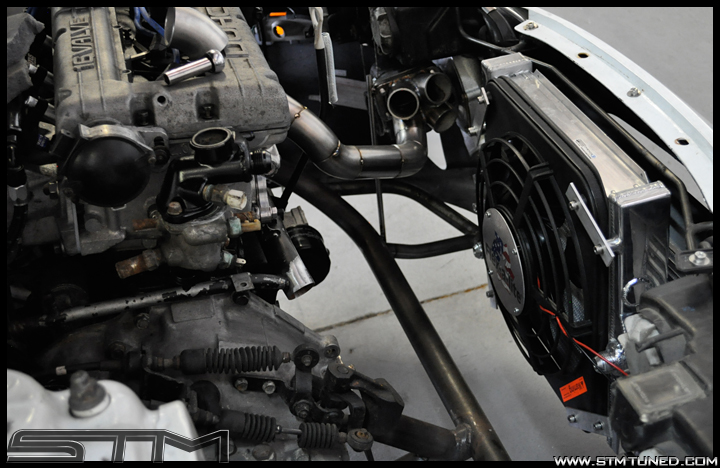

Flex-A-Lite fan is mounted, above, ready to move some air.
AEM Digital gauges are installed in the gauge cluster along with the Sparco Lap 5 steering wheel. Most of the wiring is finished and the full black leather interior will be detailed and flawless soon enough. :thumb: (Yeah, I'm jealous too.)
