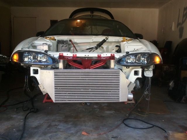

Got my lights back, and I must say I am soooo excited to see what 2gb eclipse light will look like on a 2gb talon.  I took the time to swap the lenses so I won't have that gap between the bumper and the lens.

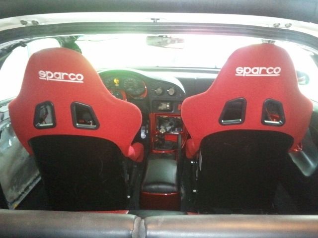

I will have to say that Mitsubishi, Chrysler I suppose in my case really dropped the ball with the rear bumper. #That thing was a pain in the aaarrsss!!! #But I got it on.
Also got both seats in. #Thanks to my good friend, kidtsi's help with the first one. #A little measuring and holding my mouth the right way and it was easy. #Now I'm just waiting one my new door locks then I can put my door panels back on.

Still here been getting ready for my baby. I got the lights put on. If anyone has a talon tail light harness I could use them.
